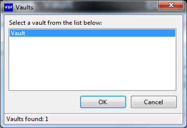

Vault Browsing | |
The login dialog allows the user to select from a list of the vaults available on a particular server. ![]() |
