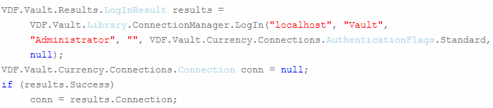

The VDF Connection class provides access to a WebServiceManager instance that shares the same Vault server connection, so any existing code written using the 2013 SDK's WebServiceManager should convert easily to using the VDF connection class. Simply replace references to a WebServiceManager instance with calls to the WebServiceManager property of an active VDF Connection instance. The only other changes client applications will need is how they obtain a connection. As mentioned in the section above, client applications will have to use one of the log-in methods to obtain a VDF Connection. For client applications that would prefer to have minimal change, the VDF's non-GUI log-in maps pretty close to the WebServiceManager's constructor, and so, client applications can simply swap out the creation of a WebServiceManager with a VDF log-in. For example, these two code snippets will result in essentially the same Vault connection:
Using web service manager (C#):
Using VDF log-in (C#):
