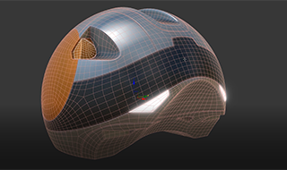

- Use the new Retopology Tools for 3ds Max to reconstruct problematic polygonal mesh data as clean quad-based topology with uncompromising accuracy.
- Reduce complex and high-resolution assets, or to enhance generative designs and traditional modeling work inside of 3ds Max.
