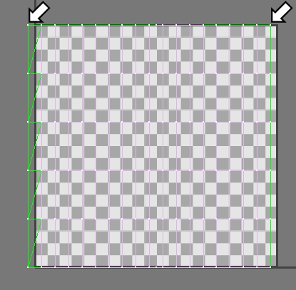

Some 3ds Max primitives have default UVW mapping coordinates that are illegal in Mudbox. For example, the default coordinates for a cylinder overlap the border of the range 0.0 to 1.0.
The default mapping coordinates for a cylinder do not match the range 0–1, and on the left the U value is less than 1.
If the coordinate range were completely inside the range 0.0 to 1.0, or completely outside it, this would be legal in Mudbox.
This situation can happen with default coordinates, and also with UVW coordinates you set up using the Unwrap UVW modifier.
