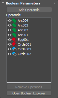

Boolean Parameters rollout
- Add Operands button
- Click to add an operand to the compound shape from either the viewport or scene explorer.
- Operands list
- Displays the operands involved in creating the compound shape. Colored icons indicate the currently performed Boolean operation, as shown in the
Operand Parameters rollout. The visibility of each operand can be toggled on and off by clicking the eye icon.
All operations applied to individual operands are carried out in sequence going from the top to the bottom of the list. You can reorder the operands in the list by dragging them.
Right-click an operand in list to access the following commands:
- Remove Operand: deletes the operand from the compound shape.
- Create New Boolean: creates a nested sub-Boolean within the compound shape.
- Rename: changes the operand name. This option does not affect the name of the original added shape.
- Disable: disables the operand from affecting the stack.
- Solo: shows the operand without any operations performed on it.
- Remove Operands
- Removes the selected operands from the compound shape.
- Open Boolean Explorer
- Opens the Boolean Explorer window. See the Boolean Explorer topic for more information.
