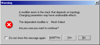

Many other types of modifiers, however, perform operations on the explicit topology of sub-object selections. The Edit modifiers and Select modifiers are examples. When a topology-dependent modifier is present on the stack, you can affect its results adversely if you visit previous stack operations and change the number or order of sub-objects (such as faces or vertices) in the selection. If you attempt this, a warning alerts you to the situation:
You can safely edit the stack beneath the topology-dependent modifier, as long as you do not add or remove sub-objects from the selection on which it operates.
