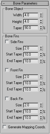

Bone Parameters rollout (creation and modification time)
These controls change the appearance of the bones. They are also available on the Fin Adjustment Tools rollout of the Bone Tools dialog.
- Width/Height
The bone's respective sizes.
- Taper
Setting Taper to 0 produces a box-shaped bone. Higher values pinch the bone where it joins its child bone, while lower values expand that end of the bone.
- Bone Fins
Use the checkboxes to toggle fins on the respective sides of the bones, and the numeric settings to control the fins' size and taper settings.
- Generate Mapping Coords
Automatically creates mapping coordinates on the bones. If you make bones renderable and apply materials, they use these mapping coordinates.
