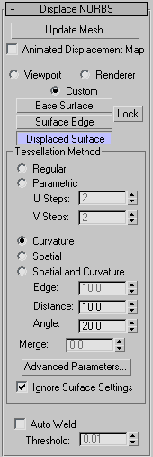

The rollout for Displace NURBS lets you choose which surface approximation settings are used to produce the mesh.
- Update Mesh
Click to update the mesh if you have changed the displacement mapping and want to see the results of the change. The mesh isn't updated automatically because that could become extremely time consuming.
- Animated Displacement Map
If you use an animated displacement map on the mesh, turn on this toggle to have the NURBS Modifier correctly update the mesh as the displacement map animates.
You can apply a Displacement map using the Material Editor.
- Viewport Uses the tessellation that the NURBS object currently uses in viewports.
- Renderer Uses the tessellation that the NURBS object currently uses for the renderer.
- Custom Uses controls in the Tessellation Method group box to set the tessellation explicitly.
- Base Surface, Surface Edge, Displaced Surface, and Lock
These controls are the same as in the surface approximation controls for NURBS objects.
Most controls in this group are the same as the Tessellation Method controls for NURBS objects.
- Ignore Surface Settings
- When turned off, Displace NURBS uses the surface approximation settings for surface sub-objects. When turned on, Displace NURBS uses the settings in the Tessellation Method group and overrides settings for surface sub-objects. Default=off.
- Auto Weld
All vertices closer than the Threshold value are automatically welded together. This can simplify the mesh geometry. It is useful to turn this on when you have increased the Merge value in order to eliminate gaps between surface edges in the approximation of the NURBS object.
