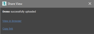

- In the Share View dialog box, specify options. Options give you additional control over information that you share with your collaborators.
- Select
Share to create a link to a visual representation of the file in
Autodesk Viewer.
A pop-up window provides the link to the shared view in Autodesk Viewer. This makes it easy for you to send the link to your collaborators .
