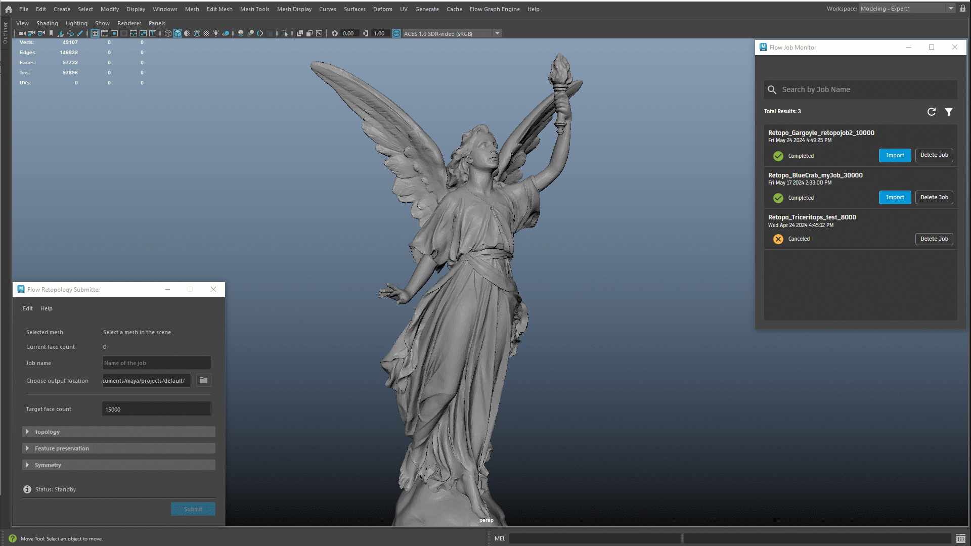

Flow Retopology for Maya
Statue of Liberty and Angel by Cults3D

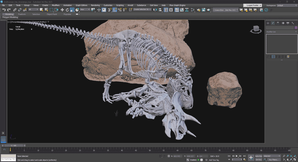

Flow Retopology for 3ds Max
Tyrannosaurus and Triceratops by The Smithsonian Institution

Use Flow Retopology when dealing with high-resolution geometry, CAD assets from other Autodesk products, or even photogrametry (scan data) created from real-world objects. Flow Retopology lets you recreate this geometry with a cleaner quad-based topology, maintaining the overall shape and necessary details. The result is a reusable asset for continued modelling, texturing, or even animation.

Flow Retopology includes a Job Monitor notification system for tracking jobs. Once a job is finished, the result is saved to disk. You can then import this result back into 3ds Max or Maya from the Job Monitor.
