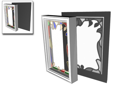

A stained glass appears solid with the transparency optimization turned off.
