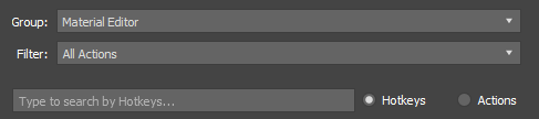

Group
Shows only the actions from a specific component group.
Filter
Filters the list of actions based on their hotkeys. You can choose to view all actions, only actions with already assigned hotkeys, only actions with customized hotkeys, or only those with unsaved hotkeys.
Type to Search
Searches any input text for matches as either actions or hotkeys, depending on the Hotkeys or Actions radio button selected to the right.

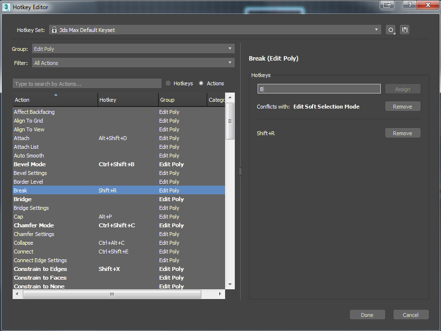

Action List
Action, Hotkey, Group, and Category Columns
Click a column name to reorder the list alphabetically by either action, hotkey, group, or category. Click the column name again to arrange the list in descending order.
Note: Actions shown in boldface can be used to override current operations. For more information, see the Actions Listed in Boldface section below.

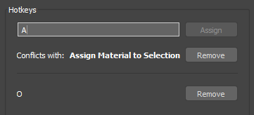

Hotkeys panel
Press Keys
Sets the hotkey or hotkey combination to assign. Click in the field and press the desired key on your keyboard. If there are no conflicts shown below, click Assign to complete the action. If a conflict is shown, you must first click Remove in order to make the key available.
Note: You cannot assign more than six hotkeys per action.
Assign
Assigns the key to the selected action.
Remove
Removes the currently-assigned hotkey for the selected action.
Undo
Restores the hotkey that was just removed.
Actions shown in boldface are used to temporarily override the current operation by pressing its assigned hotkey for longer than 0.2 seconds. For example, while editing an Editable Poly object at the Polygon sub-object level, pressing and holding Shift+Ctrl+B will temporarily activate the Bevel tool. As soon as you release the hotkey, the current operation is restored.

  4. Click in the Press keys field, then press the keyboard shortcut or combination that you want to assign to the action.
    Note: If the keyboard shortcut is already assigned to another action in the same group, the conflicting action name appears below the Press keys field.
  5. Click Remove in the case of a conflict, and then click Assign to assign the new hotkey to the action.
