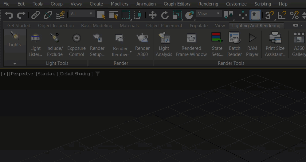

The Light Include/Exclude tool is a modeless dialog that lets you include or exclude objects on a light-by-light basis. When excluded, an object is not illuminated by the specified light and receives no shadows.
  • Design Standard workspace > Design ribbon > Lighting and Rendering tab > Light Tools panel > Include/Exclude
This dialog requires at least one light object in your scene. For a selected light, this dialog is a shortcut to the same functionality available on the Exclude/Include dialog.
Although light exclusion does not occur in nature, this feature is useful when you need exact control over the lighting in your scene. Sometimes, for example, you'll want to add lights specifically to illuminate a single object but not its surroundings, or you'll want a light to cast shadows from one object but not from another.
Note: By default, no objects are excluded for a new light. It’s necessary only to include objects that have previously been excluded.
