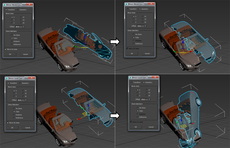

In the following illustration, the car is first mirrored, cloned, and offset in the World coordinate system with the Transform option (top-left) and the Geometry option (top-right). The bottom half of the illustration depicts the same process using the Local coordinate system.
