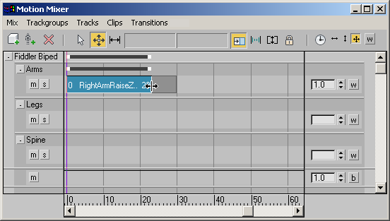

To change the length of a clip without changing its speed:
  1. On the Motion Mixer toolbar, click (Trim Clips).
  2. Drag either end of a clip to trim its length.
    A gray bar appears on a trimmed end of a motion clip.
  3. Turn off Trim Clips.
    The gray area disappears.
    Tip: At any time, you can view original clip lengths in gray by turning on Trim Clips.
    To remove scaling or trimming from a clip in the Motion Mixer, select the clip, right-click and choose Remove Scale/Trim.

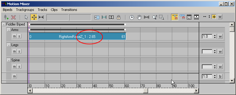

To change the speed of an entire clip:
    You can cause a motion to slow down or speed up by changing the length of the clip in the Mixer. Lengthening a clip will slow down the motion, while shortening the clip will speed it up.
  1. On the Motion Mixer, click (Move Clips).
  2. Drag either end of the clip to extend or shorten it in time.
    Tip: To see the ratio of the original motion time to the new time, click (Preferences). In the Mixer Preferences dialog, turn on Scales. This displays the ratio on the clip next to its name.
