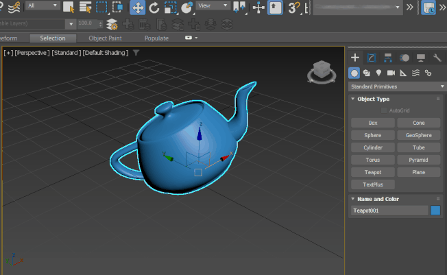

You can adjust the position and orientation of an object's pivot point at any time using the tools on the Adjust Pivot rollout. Adjusting an object's pivot has no effect on any children linked to that object.
  • Make a selection in the viewport. > Hierarchy panel > Pivot button > Adjust Pivot rollout
The Adjust Pivot rollout in the Hierarchy panel
You cannot animate the functions on the Adjust Pivot rollout. Adjusting an object's pivot on any frame changes it for the entire animation.
