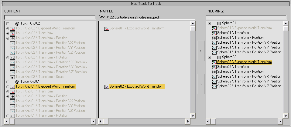

This rollout comprises three list windows. The left (Current) and right (Incoming) show node/controller hierarchies, as in Track View.

Current list
Shows animation tracks for selected objects in the scene, using the same hierarchical display as Track View. Unassigned tracks use black characters, while assigned tracks use gray characters.
Status
This read-only field shows the number of controllers and the number of nodes mapped.
Mapped list
Shows tracks that have been mapped.
Assigns the highlighted animation track in the Incoming list to the highlighted animation track in the Current list. The assignment then appears in the Mapped list, opposite the corresponding Current list entry.
If the two tracks don't contain comparable data, nothing happens when you click the button.
Removes the highlighted Mapped list entry.
Incoming list
Shows animation tracks in the loaded XAF file, using the same hierarchical display as Track View. Unassigned tracks use black characters, while assigned tracks use gray characters.
