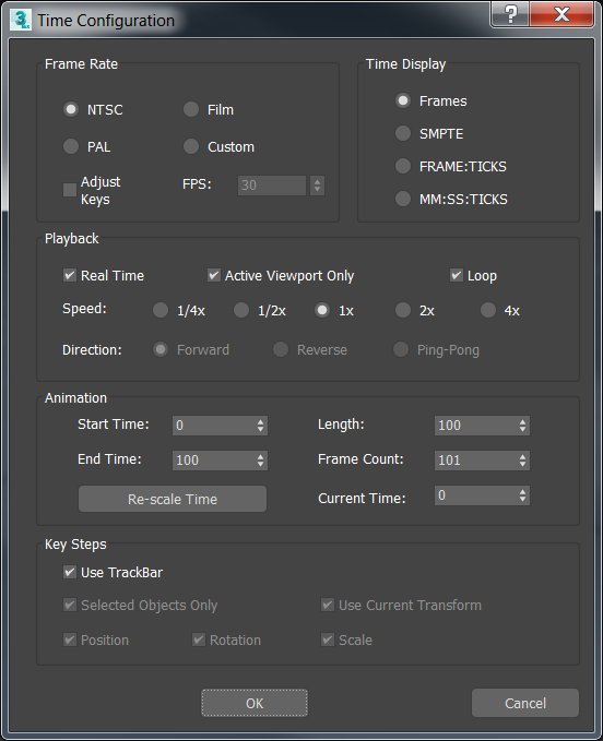

Interface
These are the controls for the Time Configuration dialog. You can display this dialog by right-clicking any of the time control buttons to the right of the Auto Key button.
Frame Rate group
These four option buttons, labeled NTSC, Film, PAL (Phase Alternate Line), and Custom let you set the frame rate in frames-per-second (FPS). The first three buttons force the standard FPS for that choice. The Custom button lets you specify your own FPS by adjusting the spinner.
- FPS (Frames Per Second)
- Sets the frame rate of your animation in Frames per Second. Use frame rates of 30 fps for video, 24 for film, and lower rates for web and media animations.
- Adjust Keys
- Scales the keys to whole frames, forcing quantization.
Time Display group
Specifies the method for displaying time in the time slider and throughout 3ds Max (in frames, in SMPTE, in frames and ticks, or in minutes, seconds, and ticks).
For example, if the time slider is at frame 35, and the Frame Rate is set to 30 fps, the time slider would display the following numbers for the different Time Display settings:
- Frames: 35
- SMPTE: 0:1:5
- FRAME: TICKS: 35:0
- MM:SS: TICKS: 0:1:800
SMPTE is the Society of Motion Picture Technical Engineers standard used to measure time for video and television production.
Playback group
- Real Time
- Real Time causes viewport playback to skip frames to keep up with the current Frame Rate setting.
When Real Time is off, viewport playback occurs as rapidly as possible and displays all frames.
- Active Viewport Only
- Causes playback to occur only in the active viewport. When off, all viewports display animation.
- Loop
- Controls whether the animation playback occurs only once, or repeatedly. When on, playback repeats until you stop it by clicking an animation control button or the time slider channel. When off, the animation plays once and then stops. Clicking Play rewinds to the first frame and plays again.
- Speed
- A choice of five playback speeds is available: 1x is normal speed, 1/2x is half speed, and so on. The speed settings affect only the playback in the viewports. Default=1x.
These speed settings can also be used with the Motion Capture utility.
- Direction
- Set the animation to play forward, reverse, or ping-pong (forward and then reverse, repeating). This affects only the playback in the interactive renderer. It does not apply when rendering to any image output file. These options are available only when Real Time is off.
You can recall these settings automatically upon startup or reset by saving a maxstart.max file. See Startup Files and Defaults.
Animation group
- Start Time / End Time
- Sets the active time segment displayed in the time slider. Choose any time segment before or after frame 0. For example, you can set an active time segment from –50 to 250.
- Length
- Displays the number of frames in the active time segment. If you make this greater than the total frames in the active segment, the End Time field increases accordingly.
- Frame Count
- The number of frames that will render. Always the length plus one.
- Current Time
- Specifies the current frame for the time slider. As you adjust this, the time slider moves accordingly and the viewport updates.
- Re-scale Time
- Click to open the Re-scale Time dialog.
Key Steps group
Controls in this group let you configure the method used when you turn on Key Mode.
- Use TrackBar
Allows key mode to honor all keys in the track bar. This includes any parameter animation in addition to transform keys.
To make the following controls available, turn off Use TrackBar.
- Selected Objects Only
Considers only the transforms of selected objects when you use Key Steps mode. If you turn this off, the transforms of all (unhidden) objects in the scene are considered. Default=on.
- Use Current Transform
Disables Position, Rotation, and Scale and uses the current transform in Key Mode. For example, if the Rotate button is selected in the toolbar, you stop at each rotation key. If none of the three transform buttons are on, Key Mode considers all transforms.
To make the following control available, turn off Use Current Transform.
- Position, Rotation, Scale
Specifies which transforms are used by Key Mode.
Clear Use Current Transform to make the Position, Rotation, and Scale checkboxes available.
