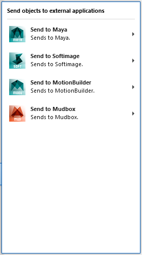

Sending Geometry to and from Other Autodesk Products
The Send To submenu provides interoperability with other Autodesk products.
  • File menu > Send To > Send To submenu
  • Establish a connection from the File menu. > Modify geometry. > 3ds Max status bar > (Update Current Scene)
  • Establish a connection from the File menu. > 3ds Max status bar > Click to break the connection (or close the current 3ds Max scene, or do the same in the other application).
Important: You must have installed an equivalent version of the other application to see the Send To command options available in the File menu. For example, Maya 2017 and 3ds Max 2017 are equivalent versions.
The Send To commands establish a connection between 3ds Max and the target application. While the connection is established, the applications share data. To break the connection, simply close the scene in one of the applications, exit one of the applications, or use Send To to send to a different target application: Each application can be connected to only one other application at a time.
