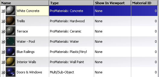

  • Best Fit options Choose Best Fit to resize the column whose label you right-clicked, or choose Best Fit (All Columns) to resize all columns. Columns are resized to fit the width of their contents.
Tip: Right-clicking a column label and choosing Best Fit (All Columns) is a good way to see the information in your current window layout.

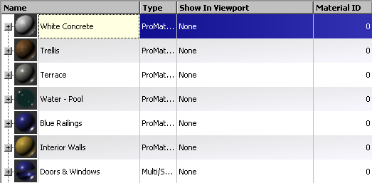

Default column layout
Column layout after right-clicking a column label and choosing Best Fit (All Columns)
