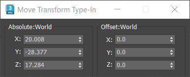

Transform Type-In Dialog
Note: While you can use units other than generic units, they appear in the dialog. For example, if you set millimeters -14.5mm the "mm" also shows in the field. Use Scene Unit to set custom units.
Absolute group
X, Y, and Z
Display and accept entry for absolute values of position, rotation, and scale along each axis. Position and rotation are typically displayed in world units, although this can vary depending on the active reference coordinate system. Scale is always displayed in local units.
Offset group
X, Y, and Z
Display and accept entry for offsets of the position, rotation, and scale values along each axis.
Displayed offset values revert to 0.0 after each operation. For example, if you enter 45 degrees in a Rotate Offset field, when you press Enter, 3ds Max rotates the object 45 degrees from its previous position, increases the Absolute field value by 45 degrees, and resets the Offset field to 0.0.
Offset labels reflect the active reference coordinate system. The Offset can be Offset: Local, Offset: Parent, and so on. If you use Pick to select the reference coordinate system of a particular object, the Offset will be named with that object.
