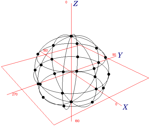

Example 1: Uniform Spherical Distribution
Example of uniform spherical distribution
A sphere centered around the origin is a representation of uniform spherical distribution, also known as isotropic distribution. All the points in the diagram are equidistant from the center and therefore light is emitted equally in all directions.

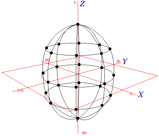

Example 2: Ellipsoidal Distribution
Example of ellipsoidal distribution
In this example, the points in the negative Z direction are the same distance from the origin as the corresponding points in the positive Z direction, so the same amount of light shines upward and downward. No point has a very large X or Y component, either positive or negative, so less light is cast laterally from the light source.
