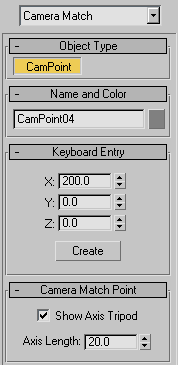

Clicking CamPoint displays the Keyboard Entry and Camera Match Point rollouts, which you use to create and name the camera points.

(Helpers). - Choose Camera Match from the drop-down list, then on the Object Type rollout, turn on CamPoint.
You are now ready to create a camera point.
- Click in the viewport to create a CamPoint helper object. Alternatively, you can use the keyboard to create a CamPoint object by expanding the Keyboard Entry rollout, entering values in the fields, and then clicking Create.

Name and Color rollout
Lets you name the CamPoint object before you create it. If you want to name it after you create it, change its name in the Modify panel.
- X, Y, Z
Let you enter the X, Y, and Z coordinates where a CamPoint object will be inserted. Field values reflect the current Unit setup.
- Create
Inserts the CamPoint object into the scene.
- Show Axis Tripod
Controls whether an axis tripod is displayed with the Camera point object. Default=on.
- Axis Length
Controls the length of the axis tripod. When Show Axis Tripod is on, you can watch the tripod change length in the viewport while you adjust the spinner arrows. When Show Axis Tripod is off, you can adjust the Axis Length value, but the axis tripod won't be displayed.
