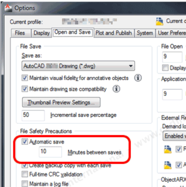

    • Autosave and SAVETIME can also be set in OPTIONS on the Open and Save tab.
Automatic save setting in AutoCAD OPTIONS.
