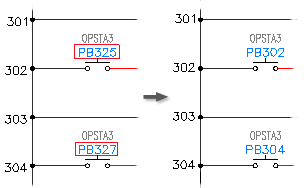

Retag recalculates each selected primary component tag, and updates the related components. You can update a single component, a group of components, a drawing, drawings within your project, or the entire project.
Run Retag Components when something changes on your drawing or project that affects the component tags. It can include revising the ladder line reference numbers or changing the tag format. Retag recalculates each selected primary component tag, and then updates the related components. The Tag format is set up on the Drawing Properties Components dialog box.
