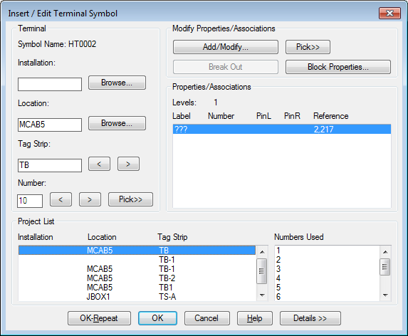

- Select the round terminal on rung 217. The Insert/Edit Terminal Symbol dialog box displays, where you can annotate the terminal properties and associations.
- In the Insert/Edit Terminal Symbol dialog box, Project List section, select Tag Strip TB.
- Enter Location: MCAB5 and
Number: 10.
- Click Details >>.
- In the Catalog Data section, click Catalog Lookup.
- On the Catalog Browser dialog box, enter the search string SIEMENS MULTI-LEVEL 20AMPS.
- Click
- Select part 8WA1 011-3JF16 and click OK.
The Manufacturer and Catalog information for the selected part displays in the Catalog Data section of the Insert/Edit Terminal Symbol dialog box.
- On the Insert/Edit Terminal Symbol dialog box, click OK.
