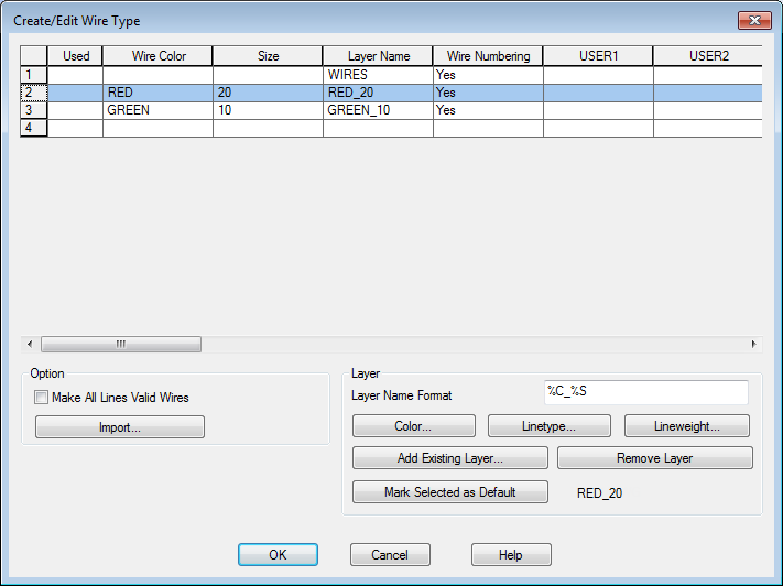

  1. Click Schematic tabEdit Wires/Wire Numbers panelCreate/Edit Wire Type. Find
  2. In the Create/Edit Wire Type dialog box, specify:
    Wire Color:  RED
    The Layer Name is automatically created. The name RED_20 is assigned to the wire layer you are creating.
  3. Click Color.
  4. In the Select Color dialog box, select red and click OK.
  5. Click Linetype.
  6. In the Select Linetype dialog box, select Continuous and click OK.
  7. In the Create/Edit Wire Type dialog box, specify:
    Wire Color:  GREEN
    Color:  Green
    Linetype:  Hidden2
    Note: If HIDDEN2 is not available, click Load. Select it from the list of line types on the Load or Reload Linetypes dialog box.
  8. Select RED_20 in the grid and click Mark Selected as Default.
  9. Click OK.

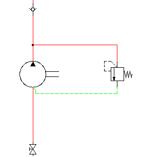

  10. Click Schematic tabInsert Wires/Wire Numbers panelWire. Find
  11. Respond to the prompts as follows:
    Specify wire start or [wireType/X=show connections]:
     Enter X and press ENTER
     Select the bottom of the shut off valve
    Specify wire end or [Scoot/T=wiretype, X=show connections]:
     Select the top of the check valve
  12. Continue inserting wires connecting the components together. Right-click to exit the command.
    Your drawing should look like the following:
    Note: You can also insert the vertical or horizontal pipes first and then insert the components onto the pipe, one at a time.
  13. Click Schematic tabInsert Components panelInsert Hydraulic Components. Find
  14. In the Insert Component: Hydraulic Symbol dialog box, select the check box for Vertical.
  15. In the Insert Component: Hydraulic Symbol dialog box, click Pressure Relief Valves.
  16. In the Hydraulic: Pressure Relief Valves dialog box, click N.C. Pressure Relief Valve with Preset -1.
  17. Respond to the prompts as follows:
    Specify insertion point:  Select to place the valve to the right of the pump
  18. In the Insert/Edit Component dialog box, specify:
    Component Tag:  VAL4
    Description: Line 1:  Pressure Relief
    Click OK.
  19. Click Schematic tabInsert Wires/Wire Numbers panelWire. Find
  20. Respond to the prompts as follows:
     Enter X, pressENTER
     Press SHIFT + right-click and select Midpoint from the menu, then select the midpoint on the pipe between the pump and the shut off valve above it
    Specify wire end or [V=start Vertical/H =start Horizontal/Continue):
     Drag the pipe to the right so that it is directly above the pressure relief valve. Drag the pipe down and click the top connection point on the pressure relief valve
    You now insert a pipe that connects the end of the valve back to the pump.
     Enter T, pressENTER
    Select the wire layer GREEN_10. Click OK.
    Tip: Make sure that Snap is turned off and that the Wire Layer is set to GREEN_10.
     Select the bottom connection point on the pump
     Drag the pipe down and to the right, click the connection point at the bottom of the pressure relief valve, right-click
