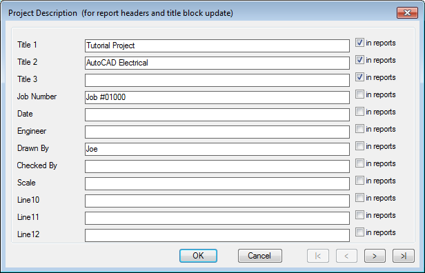

The title block and project description dialog boxes in AutoCAD Electrical toolset display generic labels like “LINE1”, “LINE2”, and so on. You can change these labels so they match up with the link to the title block. For example, you have linked the AutoCAD Electrical toolset data “LINE4” value to the “JOB#” attribute on the title block. What you want to see when AutoCAD Electrical toolset displays a title block-related dialog box is not “LINE4” but “Job Number.” A text file with a WDL extension defines the custom labels.

  7. In the Project Manager, right-click the project name, and select Descriptions.
    The labels match the values in the WDL file.
