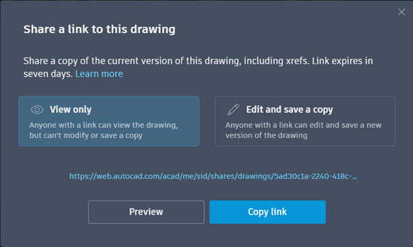

If you're looking for the quickest way to share a copy of your drawing with collaborators, try sharing a web link to the drawing using the AutoCAD web app, AutoCAD 2022, or AutoCAD LT 2022.
Sharing a link is especially useful if you ever find yourself trying to share an AutoCAD drawing with someone who doesn’t have AutoCAD installed. The recipient only needs an Autodesk ID to open and view the drawing. It’s an effective way to share a drawing with non-AutoCAD users because the recipient avoids the extra effort of installing any software. When they open the drawing, they’re presented with the AutoCAD web app’s simplified and easier-to-navigate interface.
Let's try sharing a drawing from AutoCAD desktop.
  1. Open a drawing in AutoCAD 2022 or AutoCAD LT 2022. Alternatively, you can use the AutoCAD web app by going to web.autocad.com.

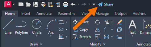

  2. Click the Share button at the top of the ribbon, or enter SHARE at the Command prompt.
    The Share dialog box opens.
  3. Choose a permission setting.
    • View only. Anyone with the link can view the drawing, but they can't make changes to the drawing or save a copy of it.
    • Edit and save a copy. Anyone with the link can modify the drawing and save a copy of it.
    Note: Recipients won’t be able to modify the original drawing, so you don’t need to worry about someone changing anything in your own version.
  4. Click Copy Link.
  5. Paste the link into a web browser.
    Note: The AutoCAD web app is supported by Google Chrome, Mozilla Firefox, and Microsoft Edge. For the best performance, make sure the browser is up to date.

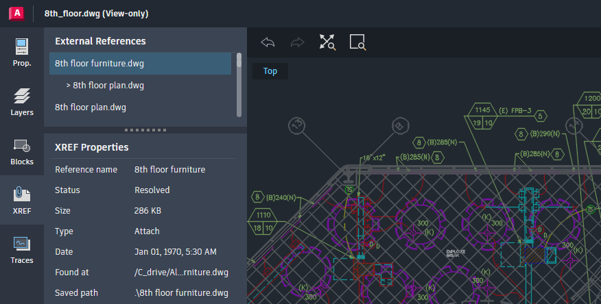

    SHARE packages the file and all its references as a URL that can be opened in the AutoCAD web app. Anyone with the link will be able to open the drawing on the web. The link expires after seven days.
    View only drawings are labeled “View-only,” and you’ll notice that the Save, Plot, and drawing tools have been disabled. If the drawing was shared with editing and saving permissions, when the user saves the drawing to a specified location, any references attached to the drawing will be saved to that same location.

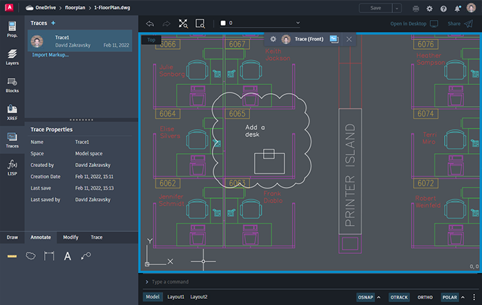

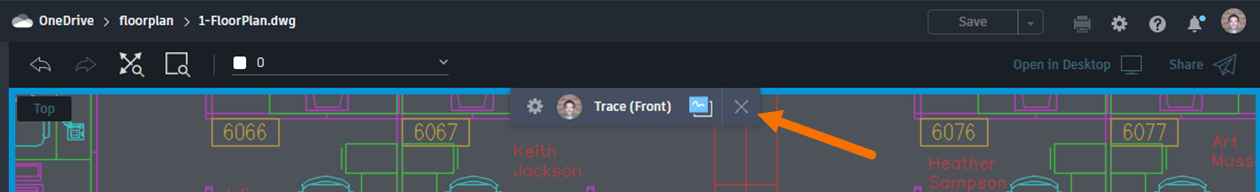

  3. After the drawing opens, launch the Traces palette and create a new trace.
  4. Add some markups to the drawing using any of the normally available commands and tools.
  5. When you're finished, click the check mark.
  6. Save the drawing.

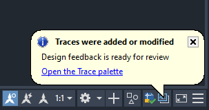

  1. Open the drawing in AutoCAD desktop, then use the TRACEPALETTEOPEN command to open the Traces palette.
    Note: If you share the drawing with a collaborator, they'll receive a notification saying that design feedback is ready for review.

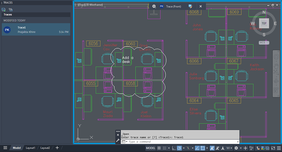

  2. On the Traces palette, click the name of the trace to open.
    The Trace environment opens.
  3. With the trace open, try exploring the environment a little. Use the button at the top of the Trace workspace to move the trace to the front of or behind the drawing.
    You can also use the TRACEFADECTL system variable to control the opacity of the trace.
  4. Create some geometry while the trace is open.
    That geometry is added to the drawing, making it easy to incorporate any changes to the drawing while the trace is open.
    Note: Editing a trace is not available in AutoCAD desktop, so any changes made while viewing a trace are made on the drawing itself.
  5. When you're finished, click the check mark to close the trace.
