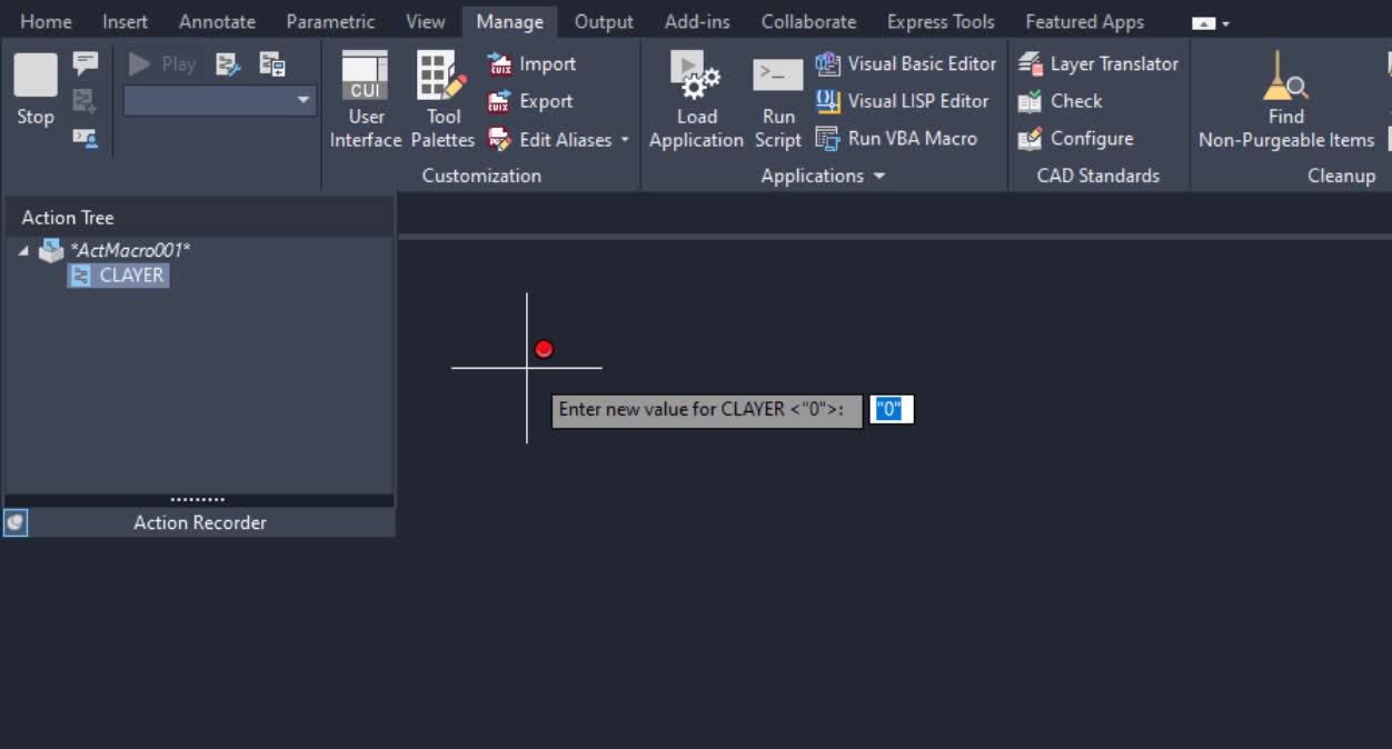

  3. On the ribbon, click Manage tab > Action Recorder panel > Record. Find
  4. At the Command prompt, enter CLAYER and then enter a name of Dimensions.
    Notice the CLAYER system variable is recorded and shown in the Action Tree.
