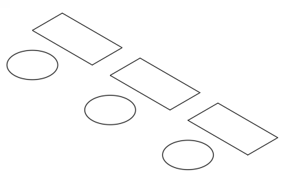

Create a Simple 3D Model

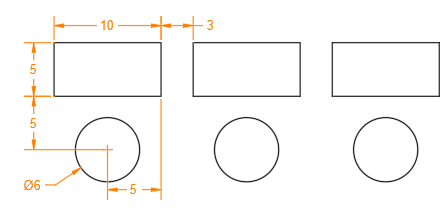

To start, create three rectangles using the RECTANG command and three circles like this:

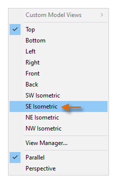

In the upper-left corner of every viewport, there are three controls:
[-] [Top] [2D Wireframe]
You can click each one of the three bracketed areas to change various settings and controls.
  • The [-] menu includes options for displaying several viewports or controlling the display of view navigation tools.
  • The [Top] menu includes a list of standard and custom views.
  • The [2D Wireframe] menu includes a list of available visual styles.
Go ahead and click the [-] control, look at menu, and press Esc. Do the same for the [Top] and [2D Wireframe] controls. The titles will change to display the current setting.
  1. Click the control labeled [Top] and then choose SE Isometric from the menu.
    This operation displays an isometric view of the drawing.

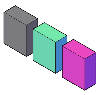

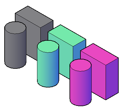

  2. Enter EXTRUDE at the Command prompt and select all six objects.
  3. Enter 12 as the extrusion distance.
Visual Styles
You've just created six 3D solids that are displayed using the 2D Wireframe visual style. Visual styles determine the display of edges, lighting, and shading in each viewport. Let's explore these visual styles.
  1. First change the colors of the 3D solids using the Properties palette or the ribbon control as shown.

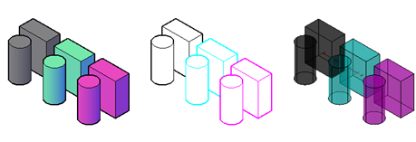

  2. From the viewport controls, click [2D Wireframe] and choose Conceptual from the menu.

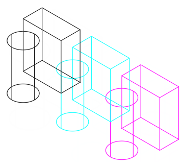

  3. From the same menu, choose each of the other visual styles to see what they look like and then return to the Conceptual visual style. Below are examples of the Conceptual, Hidden, and X-ray visual styles.
Note: The X-ray visual style is often handy when you need to specify object snaps for measurement commands such as DIST and MEASUREGEOM in 3D.

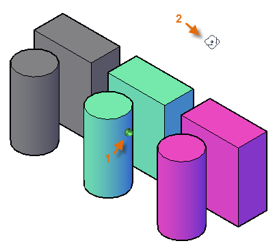

Rotate 3D Views Dynamically
You can easily rotate the view of a model dynamically, which gives you the advantage of parallax to make a complex model easier to comprehend as compared to a static view.
  1. Press and hold down Shift and then press and hold down the mouse wheel.
  2. While keeping Shift and the mouse wheel pressed down, move the mouse around.
    While in this mode, you can see both a dark-green ball (1) that indicates the target point about which your view rotates. Also, your cursor changes to a view rotate cursor (2). Your cursor location is important when you use the scroll wheel to zoom in and out.
  3. Release the Shift and the mouse wheel to stop changing the view.
  4. To return to a standard view, click [Custom] from the viewport controls and choose SE Isometric again.

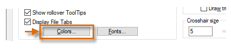

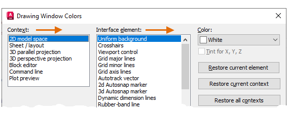

  1. Enter OPTIONS to display the Options dialog box and click the Display tab, Colors button.
    The relevant contexts in the left column are 2D model space, 3D parallel projection, and 3D Perspective projection.
  2. Under Context, choose 2D model space, under Interface Element, choose Uniform background, and under Color, choose White.

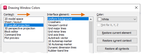

  3. Repeat step 2 for the Context, 3D parallel projection, using the same choices.

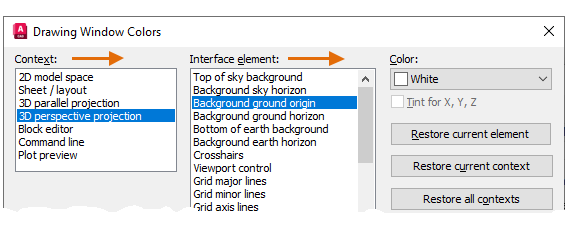

  4. Under Context, choose 3D perspective projection and make the choices indicated below.
  5. Click Apply & Close and then OK.

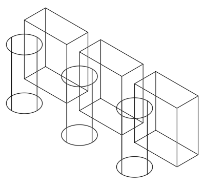

Perspective views can be helpful for illustration, presentation, and rendering purposes. The illustration below displays a parallel projection along with a perspective projection to its right.

  1. Click the second control, which might be set to [SE Isometric] or [Custom] and choose Perspective from the menu.
  2. Use the previous method where you press and hold Shift and the mouse wheel to change the view dynamically. Note that you can also use the scroll wheel to zoom in and out of the model.
  3. When you're done viewing in perspective, switch back to Parallel.
