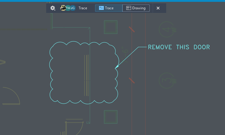

Trace provides a safe space to provide feedback to a drawing without altering the existing drawing. The analogy is of a virtual collaborative tracing paper that is laid over the drawing that allows collaborators to add markups and comments on the drawing.

  2. Add markup or additional design details to the trace.
  3. Save the drawing, then share it with a colleague or collaborator.

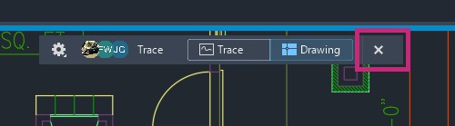

When colleagues open the drawing in AutoCAD desktop (Windows or Mac), they’re notified of any new traces. Recipients can open the trace to see what was added, then make decisions on the feedback that’s included.
