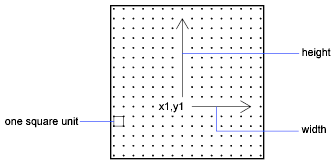

The following figure is an example of a 16 x 16 dot matrix that you could use to design an extended Big Font, such as a Kanji character. In the example, the distance between each dot is one unit. The callout points to a square unit.
A square matrix for a Kanji character
