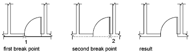

Break Objects
Use BREAK to create a gap in an object, resulting in two objects with a gap between them. BREAK is often used to create space for block or text.
You can create breaks in most geometric objects except blocks, dimensions, multilines, and regions. As an alternative, use EXPLODE on these types of objects, and create breaks in the dissociated geometry.
To break an object such as a line, arc, or open polyline at a single point without creating a gap, use BREAKATPOINT instead.
