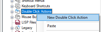

  1. In the Customize tab, Customizations In <file name> pane, right-click the Double Click Actions node. Click New Double Click Action.

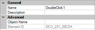

    The new double-click action (named DoubleClick1) is placed at the bottom of the Double Click Actions node.
  2. Right-click DoubleClick1. Click Rename and enter a new double-click action name.
  3. In the Properties pane, do the following:
    • In the Description box, enter a description for the double-click action.

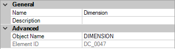

    • In the Object Name box, enter a DXF name or one of the special object names used for an insert object. The value will automatically be converted to uppercase after the box loses focus.

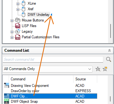

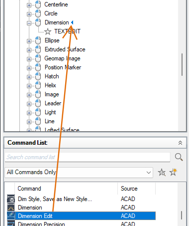

  4. In the Command List pane, drag the command you want to add to the double-click action in the Customizations In <file name> pane.
    Note: Only a single command can be associated with a double-click action at a time.

  4. In the Object Name box, enter a DXF name or one of the special object names used for an insert object.
  5. If you want to replace the current command assigned to the double-click action, drag a command from the Command List pane to the double-click action in the Customizations In <file name> pane.
