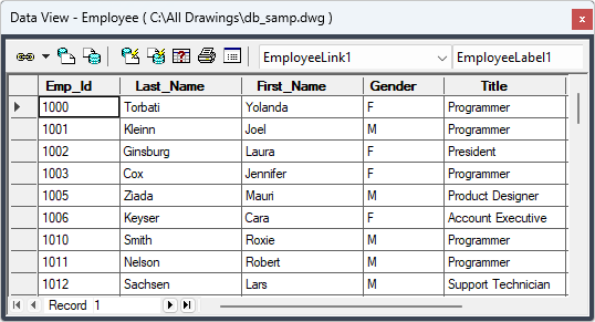

The Data View window displays records from the selected database table. The Data View contains a set of buttons, a grid window for viewing and editing records, and a set of navigation controls for navigating through the record set. After you open the Data View window, the Data View menu is added to the menu bar. You can specify whether the Data View window can be docked or anchored by right-clicking the title bar and choosing an option from the shortcut menu.
The appearance of the Data View window is governed by your computer's system settings, and it can be changed in the Windows Control Panel. Text in the cells is displayed using the system window text color. If the database table is opened in Read-only mode, the cell background is shown using the system 3D objects button shade color (light gray by default). If it is opened in Edit mode, the cell background is shown using the system window color (white by default). When a cell is selected, it is shown using the system- selected items background and text colors.
List of Options
The Data View window has the following components.
Data View Buttons

Data View Grid Window
Displays a subset of the records from a database table. You can select records by clicking the following elements:
  • Column header: Selects all records in that column. Double-clicking a column header sorts its records in ascending order. Double-clicking a column header a second time sorts its records in descending order.
  • Record header: Selects an individual record. Double-clicking a record header selects any graphical objects that the record is linked to in the drawing area.
  • Grid cell: Selects one field of a given record. Double-clicking a cell selects it for editing.
  • Grid header: Selects the entire table. Double-clicking the grid header commits any changes made during an editing session and closes the Data View window.
