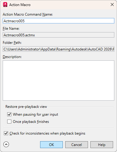

Action Macro Dialog Box
Saves or cancels a recorded action macro.
ACTSTOP (Command) Find
You can save or rename the current action macro and define its playback behavior. Display of this dialog box can be suppressed by clearing the Prompt for Action Macro Name setting in the Action Recorder Preferences dialog box.
List of Options
The following options are displayed.
Action Macro Command Name
Specifies a name for the current action macro. You can enter a new name to replace the displayed default name.
File Name
Displays the file name for the current action macro.
Folder Path
Displays the location where the current action macro file is stored.
Description
Specifies a description for the current action macro. The description is displayed in a tooltip when the cursor hovers over the top node of the action macro in the Action tree.
More Options
Controls the display of additional options in the Action Macro dialog box.
Restore Pre-Playback View
Defines how the view that was in effect prior to the playback of an action macro is restored.
  • When Pausing for User Input. Restores the view prior to the playback of an action macro when a request for user input occurs.
  • Once Playback Finishes. Restores the view prior to the playback of an action macro when playback is complete.
Check for Inconsistencies When Playback Begins
Specifies if the action macro should be scanned for inconsistencies between the current drawing state and the drawing state when the macro was recorded.
