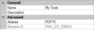

  3. Select the new pull-down menu, and update its properties in the Properties pane:
    • (Optional) In the Name box, edit the text string to include special characters or a DIESEL expression.
    • In the Description box, enter a description for the menu.
    • In the Aliases box, an alias is automatically assigned to the new menu, based on the number of pull-down menus already loaded. For example, if the alias assignment is POP12, eleven pull-down menus are already loaded. Edit the alias as necessary.
