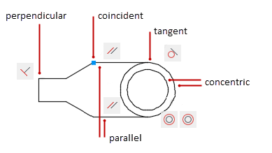

You can apply geometric constraints to associate 2D geometric objects together, or specify a fixed location or angle.
For example, you can specify that a line should always be perpendicular to another one, that an arc and a circle should always remain concentric, or that a line should always be tangent to an arc.
When you apply a constraint, you will notice three changes:
- The object that you select adjusts to conform to the specified constraint
- By default, a constraint icon displays near the constrained object as shown in the previous illustration: coincident constraints display as small blue squares, and all other constraints display as gray icons
- A cursor badge displays when you move your cursor over a constrained object
Once applied, constraints permit only those changes to the geometry that do not violate the constraints. This provides a method for exploring design options or making design changes while maintaining the requirements and specifications of the design.
