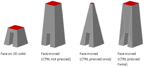

Several results are possible when you modify a solid or surface. When you move, rotate, or scale subobjects, you can press Ctrl one or more times as you drag to cycle through modification options.
The following illustration shows the modification options for moving a face.
