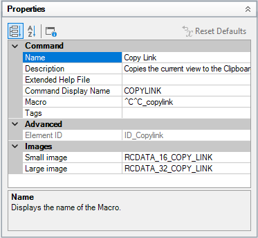

The following example disables the Copy Link menu item by adding a tilde (~) to the front of the value in the Name property.

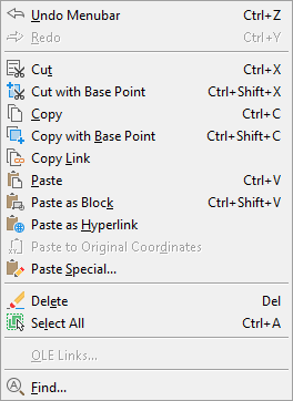

The following is the result of adding a tilde (~) to the Name property for the Copy Link menu item that appears on the Edit menu.

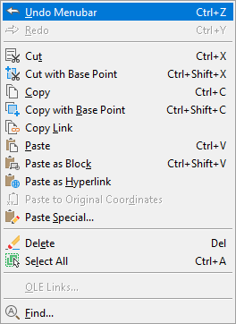

The following example shows the OLE Links menu item on the Edit menu marked with a check mark and the Copy Link menu item's image highlighted with a border around it.
