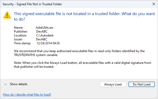

Digital signature verified and the file hasn't been changed
Recommendation: File should be safe to load, but you will want to verify the source of the file if it is being loaded the first time.
Solution: Load and use the file as expected. Optionally, trust the publisher to avoid the message box in the future for all files signed by the publisher.

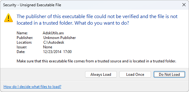

Digital signature couldn't be verified
A digital signature can't be verified for the following reasons:
  • File isn't signed or was incorrectly signed
  • File is unsigned, but the digital certificate to validate against isn't installed in the 'Trusted Root Certification Authorities' store
Recommendation: Verify the source of the file and that the digital certificate used to sign the file has been installed.
Solution: Install the digital certificate used to sign the file into the 'Trusted Root Certification Authorities' store. See "To Import a Digital Certificate" for information on how to install the digital certificate, if you or your company made the certificate.

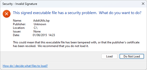

Digital signature is invalid as a result of the file being changed after it was signed
Recommendation: Don't load the file.
Solution: Obtain a version of the file that has been verified and signed. See "About Digitally Signing Custom Program Files" for information on digitally signing a file.
