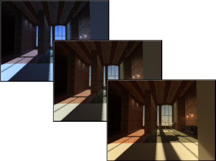

Exposure and White Balance
The exposure and white balance settings are used to control the brightness and lighting color of a final rendered image.
Exposure allows you to brighten or darken a rendered image.
White balance allows for the lighting in a rendered image to be cooled or warmed. Cool light makes the image appear blueish, while warm light makes the image appear reddish or orangish in color.
The Render Environment & Exposure palette sets the exposure and white balance settings to use when rendering.

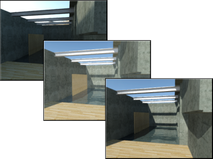

Backgrounds
A background is basically a backdrop behind the model. Backgrounds can be a single color, a multi-color gradient, a bitmap image, a simulated sun and sky, or an image-based lighting map.
Backgrounds work best when you are rendering still images, or animations in which the view doesn’t change or the camera doesn't move. Once set, a background can be associated with a named view or camera and is saved with the drawing.
All background types with the exception of an image-based lighting map can be set from the View Manager. The Render Environment & Exposure palette is used to set an image-based lighting map as the background of a viewport, and can also be used to assign one of the other background types to a viewport.
