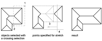

Stretch Objects
With STRETCH, you relocate the endpoints of objects that lie across or within a crossing selection window.
  • Objects that are partially enclosed by a crossing window are stretched.
  • Objects that are completely enclosed within the crossing window, or that are selected individually, are moved rather than stretched.
You stretch an object by specifying a base point and then a point of displacement.
Use object snaps, grid snaps, and relative coordinate entry to stretch with precision.
