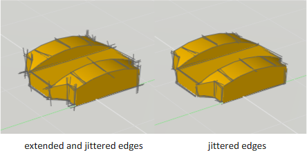

Different edge types can be displayed using different colors and linetypes. You can also add special effects, such as jitter and line extensions.
In 3D solid or surface models, the current visual style sets the visibility and appearance of isolines, facet edges, silhouette edges, occluded edges, and intersection edges. Facet edges (the edges between planar faces representing a surface) are displayed only when the angle between the facets is smaller than the crease angle value you specify.
For example, edge modifiers such as line extension and jitter, produce the appearance of a model that is still in the conceptual phase. Jitter makes lines appear as though they were sketched with a pencil. Line extension produces another kind of hand-drawn effect.
Note: Plot styles are not available for objects with the Jitter edge modifier applied.
