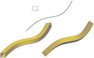

The SWEEP command creates a solid or surface by extending a profile shape (the object that is swept) along a specified path. When you sweep a profile along a path, the profile is moved and aligned normal (perpendicular) to the path. Open profiles create surfaces and closed curves create solids or surfaces.
You can sweep more than one profile object along a path.

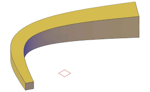

  • Scale. Specify a value that will change the size of the object from the beginning of the sweep to the end. Enter a mathematical expression to constrain the object scaling.

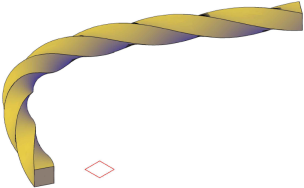

  • Twist. By entering a twist angle, the object rotates along the length of the profile. Enter a mathematical expression to constrain the object ‘s twist angle.
