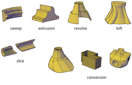

About Solids Based on Other Objects
You can also create 3D solids from 2D geometry or other 3D objects. For example, a 3D solid can also be the result of extruding a 2D shape to follow a specified path in 3D space.
The following methods are available:
  • Sweep. Extends a 2D object along a path.
  • Extrusion. Extends the shape of a 2D object in a perpendicular direction into 3D space.
  • Revolve. Sweeps a 2D object around an axis.
  • Loft. Extends the contours of a shape between one or more open or closed objects.
  • Slice. Divides a solid object into two separate 3D objects.
  • Sculpting Surfaces. Converts and trims a group of surfaces that enclose a watertight area into a solid.
  • Conversion. Converts mesh objects and planar objects with thickness into solids and surfaces.
