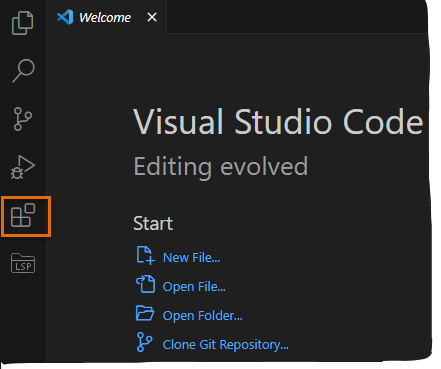

  2. In Visual Studio Code, on the Activity Bar, click Extensions (or click View menu > Extensions).

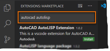

  3. In the Extensions Search box, type autocad autolisp.
  4. From the search results list, click Install under the AutoCAD AutoLISP Extension item.
    After a few moments, the extension should be installed and listed in the Installed Extensions list.

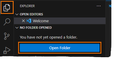

  3. In Visual Studio Code, on the Activity Bar, click Explorer and then click Open Folder (or click File menu > Open Folder/Open).
  4. In the Open Folder dialog box, browse to and select the LSP Files folder.
  5. Click Select Folder on Windows or Open on Mac OS.

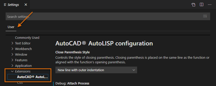

  1. In Visual Studio Code, click File menu > Preferences > Settings.
  2. On the User tab, expand Extensions and click AutoCAD AutoLISP Configuration.

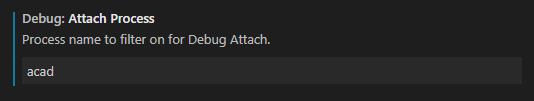

  3. In the Debug: Attach Process text box, enter one of the following values in bold:
    • (Windows) acad
    • (Mac OS) AutoCAD
    Note: The process name is case sensitive, so acad or AutoCAD isn’t the same as ACAD or autocad.

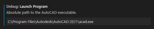

  4. In the Debug: Launch Program text box, enter the absolute path to the AutoCAD executable.
    The absolute path varies based on the release and platform on which AutoCAD was installed.
    • (Windows) "C:\Program Files\Autodesk\AutoCAD 2026\acad.exe"
    • (Mac OS) "/Applications/Autodesk/AutoCAD 2026/AutoCAD 2026.app/Contents/MacOS/AutoCAD"
