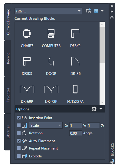

Use the Blocks palette to access and insert blocks defined in the current drawing.
You can also insert recently used blocks, favorite blocks, and blocks from libraries by opening the Blocks palette to the corresponding tab. The illustration below shows all four tabs.
Note: Blocks associated with dimension and multileader styles are included automatically when you create dimensions and multileaders, so they're not displayed in the ribbon gallery or the Blocks palette.
  • The Current Drawing tab displays previews or a list of block definitions available in the current drawing.
  • The Recent tab displays previews or a list of block definitions recently inserted or created in the current and previous sessions. These blocks can come from various drawings.
  • The Favorites tab displays previews or a list of favorite block definitions that were copied from the other tabs of the Blocks palette.
  • The Libraries tab displays previews or a list of block definitions from a single, specified drawing or a folder. Inserting a drawing file as a block also imports all of its block definitions into the current drawing. Click Browse Block Libraries () at the top of the palette to browse to a different drawing file or folder.
Note: The name of an external file that's inserted as a block includes an asterisk (*) in the Blocks palette.
You can insert a block from one of these tabs with several methods:
  • Click and place a block into the current drawing. This method applies the settings specified under Options.
  • Drag a block into the current drawing for fast placement. This method only uses the Scale and Rotation values specified under Options.
  • Right-click and choose an option.
  • From any tab in the Blocks palette, click Insert DWG as Block (). This method inserts a drawing file as a block.
Notice the placement options at the bottom of the Blocks palette. These options can save you multiple steps such as repeatedly placing a block.
Tip: To optimize your drawing area, dock the Blocks palette to either side of your application window and turn on Auto-hide from its title bar.
