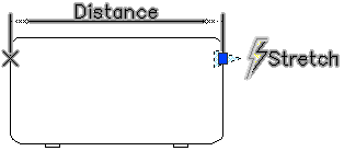

The following example shows how dependency highlighting creates a halo effect for the associated parameter (labeled Distance) and action (labeled Stretch) when you select the custom grip in the Block Editor.
